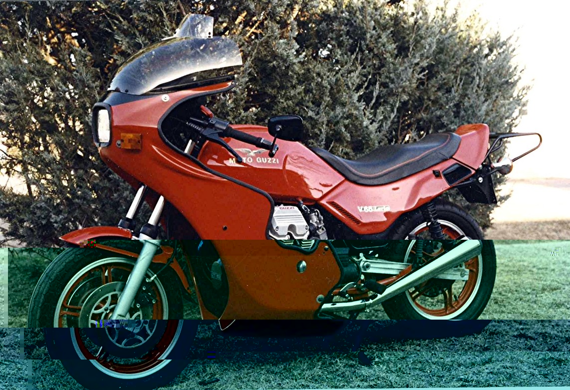

btw peter, that's a nice looking machine you've got there too. i considered doing a classic 70's ss fairing, but decided against it as i already have a couple retro bikes: my guzzi has an original agostini full fairing. unfortunately i tore it down this winter in anticipation of being finished with the duck, and i don't seem to have any good pictures of it. attached is one that's almost identical to mine. except much shinier. i might do a solo tailsection on this one too. i just don't like passengers.
