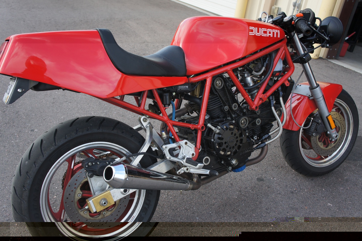

as promised, here are a few pics of the newly resurrected sport. i'm pretty happy with the paint. except for the fact that i didn't quite match the frame, my guy did a pretty good job. lots of little things to work on here and there, but i'm gonna focus on riding it this summer instead of obsessing over details.

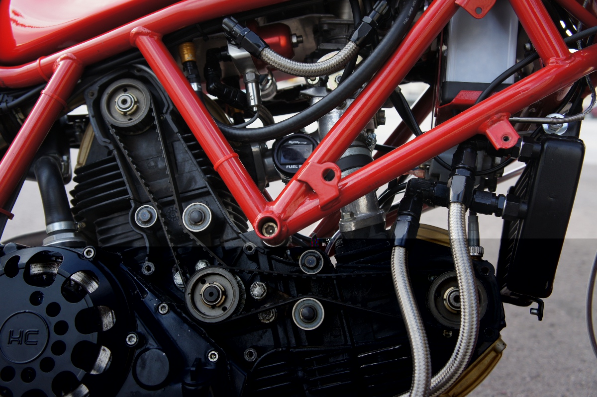

notes: the fuel system is really overkill automotive stuff, but it's bulletproof. an-6 lines are HUGE for this application, but the hardware i had selected used those fittings, so i stuck with it. i had a holley regulator on there and wasn't happy with it. the fuelab unit is a little larger, but it's rock solid and it's red. i have it set to 2.0 psi. for lack of space, i don't see my gauge while riding, so i might just pull it off when i'm satisfied with how it's running.
current jetting is 65/160/f27(i think?)/195 with 4.5 aux ventury. pretty rich almost everywhere (at 6000 ft in colorado), but it runs better than it ever has - primarily because of the solid fuel pressure regulation. idle should probably come back down to 60. not sure yet about the main, but i find myself continually moving up with the air corrector. just ordered another handful from pierce ranging up to 210. hearing of other people's experience, it looks like i may go even higher.

Mate that looks great :thumbup: .A job well done in my book.

btw if anyone's interested, the fuel system goes like this:
there's an in-tank strainer on the end of aluminum hardline picking up from the low point of the tank. goes through one of these awesome, self-sealing quick-releases: http://motorsports.jiffy-tite.com/2000- ... aV6m7VQFqU
- out of the tank on the right side just behind the regulator. up to the pump in front of the carb: http://www.holley.com/15760NOS.asp
- back on the left side to a 10 micron mini filter (hidden behind the regulator in the last pic): http://www.golanproducts.com/filters.html
- to the fuelab regulator (the really low pressure one isn't actually shown on their site): http://fuelab.com/products/performance/ ... egulators/
- to a return goes back to the tank on the left side right beside the vertical cylinder (also a quick-release fitting)
- and finally to the carb, wrapping 450 degrees around the carb.
i can't stress enough how much a difference this makes over the original. it's a completely different bike. jetting works. no surprises. i can make a change and it does what it's supposed to. and with the jiffy-tite fittings, i can take the tank off, rejet mains or air correctors, and be riding again in 10 minutes with almost no spill.

Very nice. I like the Sport a bit deconstructed. Looks a lot tougher than a Monster.

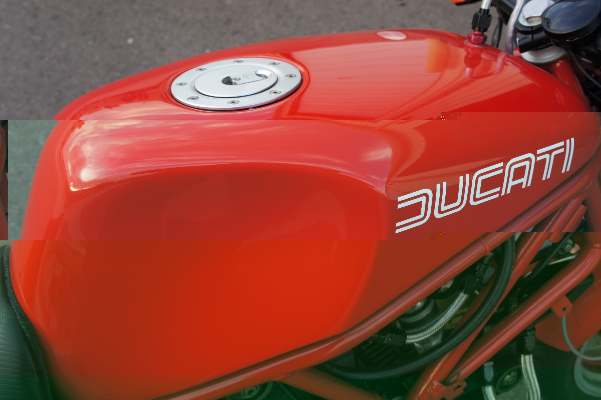

How did you modify the tank? Nice work.
The ground wire from the battery should be upsized a bit, and solder the lugs. All of your starting current is running through that wire.

right. that ground strap is prolly marginal. and i agree - i never really liked the monster's departure from its race heritage. of course the riding position is a lot more comfortable.
the tank is scratch-built composite. i picked up the basic skills hanging out with some home-built aircraft builders. i carved a foam plug (several actually) from styrofoam until i got a shape that i was satisfied with. covered it in box tape and mold release, then hand-laid fiberglass over it. aluminum reinforcements are built in for the attach points. vinyl ester resin is the stuff to use for tanks since it's highly resistant to fuels and solvents. materials come to about $200us from aircraft spruce or wicks. cheaper than an oem tank. actually with all the fittings call that $400.
after the basic shape is done, i cut the filler hole, then the foam dissolves with acetone. MESSY. box tape comes out with a little effort. a rinse with more acetone then a slosh coat of more vinyl ester. then it's fill and sand, fill and sand, fill and sand...my painter did a good job of hiding the remaining imperfections. for a pro, it's probably a pretty quick and easy project - 10 hours or so over the course of a week. for me it was very labor intensive.
i got some pics of the process around here somewhere. i'll dig em up. it's very messy and very TOXIC. proper protection and ventilation is required.
all fittings are sealed using dow 730 (80 bucks a tube!). everything's tight right now, but we'll see how well it holds up. i made a nutplate for the newton fuel cap rather than mold the fittings into the tank - mounting it this way was a little more forgiving. a fuelsafe discriminator valve at the top-front of the tank is open to atmosphere for venting. no emissions equipment here. right now i have an ugly hardline routed to the road below, but no fuel has come out. those discriminators actually work. i'd like to put one of these on there to control vapor losses:
http://www.fuelsafe.com/store/vent-chec ... valve.html
i wouldn't necessarily recommend that anyone go to all this trouble. not that it's hard, but it's a pain in the ass, and i'm just a glutton for punishment. i'm happy with the results though.

Gawd I'm slow...I did'nt even notice the tank.Did you make the seat from scratch as well.Now I am impressed.I'd love to see some photos of the tanks construction and thanks for the links too.

After looking at it a bit more, I agree that a fairing will do nicely on this bike. But not the stock fairing obviously, but maybe some styling cues from it. I'm thinking a very thin 1/4 faring from the side view. Maybe just the top of a 916 fairing. Of course cut out around those nice big lamps. A couple of inches of glass and equal amounts of windshield.

that tank is a really outstanding job. Kudos :thumbup: The whole bike does look like a fun ride.
I wasn`t asked :mrgreen: but what I personally don`t like is the missing belt covers and those headlights while I can`t decide if it`s because it`s two, they`re so big or standing forward so much.
Those front brake lines are really long. Try to get them away from the fork as they will rub into them over time and leave a deep mark also if they have a rubber coating. I`ve seen that numerous times. Also why not replace the rear line as well ?
