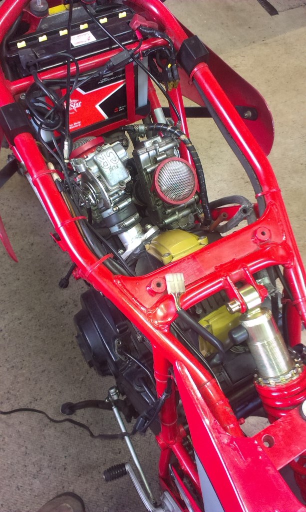

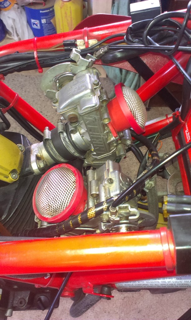

 Post subject: Re: FCR fitment
PostPosted: Tue Dec 31, 2013 11:07 pm
Posts: 322
model: other
Alternate fitting suggestion
2013-09-15 13.24.15a.jpg [199.1 KiB]
Downloaded 368 times
2013-09-15 13.23.56a.jpg [182.13 KiB]
(Andrew2 please note RED cable ties :lol: )
Peter
PostPosted: Wed Jan 01, 2014 6:02 am
Posts: 497
:shock: wonderful job you've done there Peter.
Andrew
