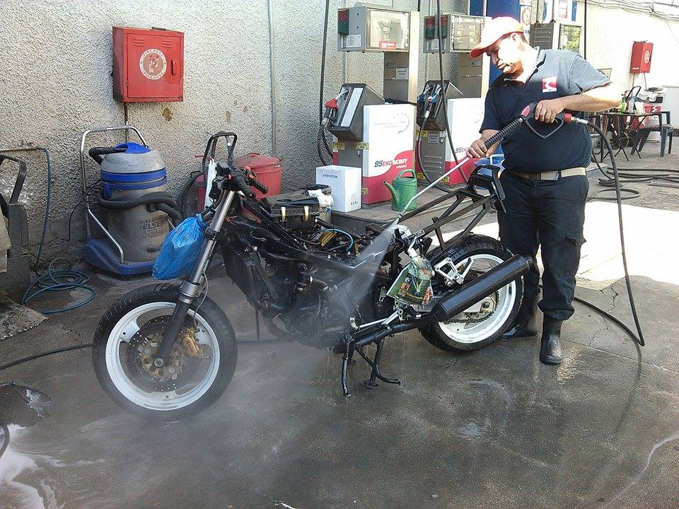

Didn't have time to do much since the last post but last week has been quite busy.
I removed as much stuff as I could and took the bike for professional cleaning. 24 years of dust and oil was gone. It needed some more manual work afterwards but the result is quite rewarding.
The frame section under the battery was corroded by battery fluid spillage so the plastic cover that holds the battery and goes all the way to the rear end was removed for gaining better access to the area.
This was a good opportunity to respray various black parts such as the corroded part of the frame, the rear grab bar, the brake calipers, upper fork plate, side and main stands etc
The front sub frame was damaged and was replaced by a good straight one from a 906 after cutting the voltage regulator plate mounts from the 907 sub frame and welding them to the 906 one. The result is quite satisfactory with the 906 sub frame looking exactly like an original 907.
The wiring harness had some really bad job done in the past on its plugs and connections so I repaired and secured everything. Also the thick wires from the battery to the starter relay and from this relay to the starter have been replaced by new and better ones.
All vibration dampers of the ECU and alternator mounting plate have also been replaced by new.
The coolant bottle has been replaced by a good used one and the coolant hose modification will come next, soon as I find a CBR filler neck.
New steel braided brake hoses have also been fitted all around.
Plastic parts are now ready for getting their new coat of paint.
After a failed attempt of having the decals made by a local shop, I managed to find original Ducati ones through the Italian ebay so problem solved.
