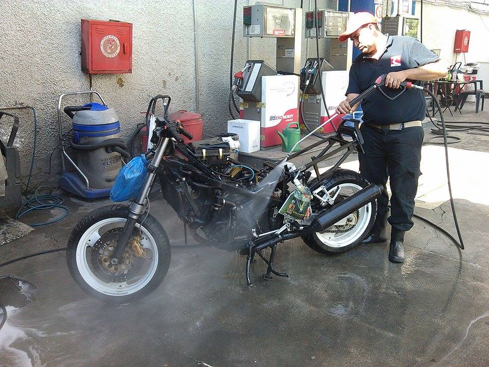

Didn't have time to do much since the last post but last week has been quite busy.
I removed as much stuff as I could and took the bike for professional cleaning. 24 years of dust and oil was gone. It needed some more manual work afterwards but the result is quite rewarding.
