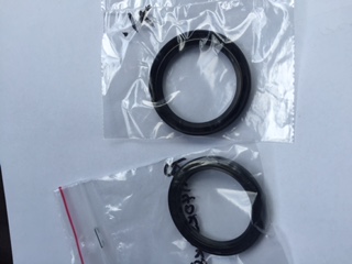

New Front Wheel Speedo Seal (a pain as I lost the old one)
Thanks to Ducinthebay (Phil) 40 x 52 x 5 Single Lip (which matches measure up after getting the numbers)

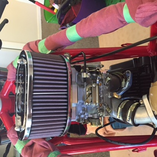

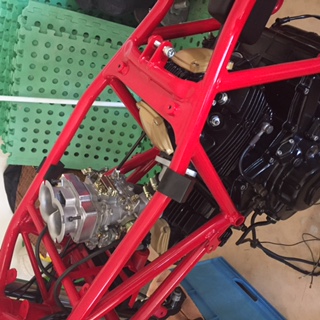

Overall with a couple of changes made to the machine I am no longer hung up on making as original .... so this means a few minor upgrades
The Carb will go with a K & N filter so in she goes .... starting to see nuances for the machine I have up to this point only read about .... here the carb goes on but doesnt sit exactly square to the frame (as it was from new)
The Weber looks good!

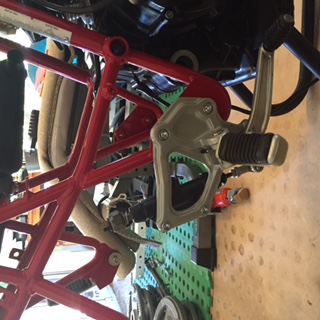

On with the FootPeg assembly I built a year plus ago
Clutch line in with new bolt & bleed
