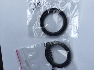

New Front Wheel Speedo Seal (a pain as I lost the old one)
Thanks to Ducinthebay (Phil) 40 x 52 x 5 Single Lip (which matches measure up after getting the numbers)
Funny thing is cannot find the F@kn Speedo Tang now

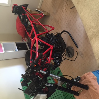

Thanks Duke in the Bay .... acquired the correct fuel hose & installed with a new fuel sensor, pump & the correct clamps
Bet you thought I had given up ...
Engine is finally back missing a couple of parts that can be added once in Frame (albeit one is a swinger bearing which makes a little tougher but do able)

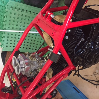

The Carb will go with a K & N filter so in she goes .... starting to see nuances for the machine I have up to this point only read about .... here the carb goes on but doesnt sit exactly square to the frame (as it was from new)
The Weber looks good!
