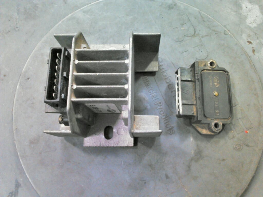

if you google Marelli BKL 3B you find lots of info. Seems these parts were installed in sevral european cars and there are alternative modules.
A list is in these two auctions:
http://www.ebay.com/itm/HUCO-Ignition-C ... r#shpCntId
HUCO is HITACHI
http://www.motorpartsworld.com/parts/ignmaumpw188915
