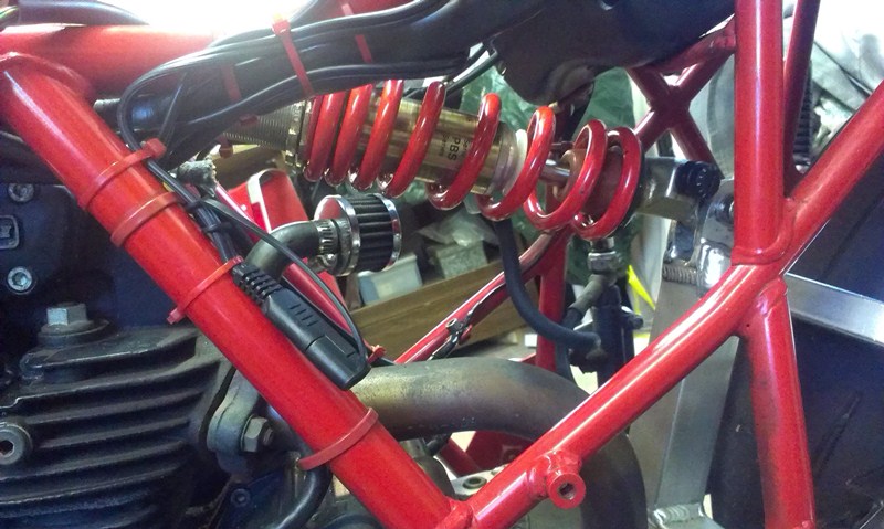

You could also contact Ian Gowanloch at Ital Spares 02 6946 2626 and see what NOS items he may have, as Phil wrote the 900SS rear shock from that series will work, had one in my Sport (trackday bike) and it worked very well indeed, it is 6 mm longer as mentioned, but drops straight in without any drama and usually doesn't cost to much.
