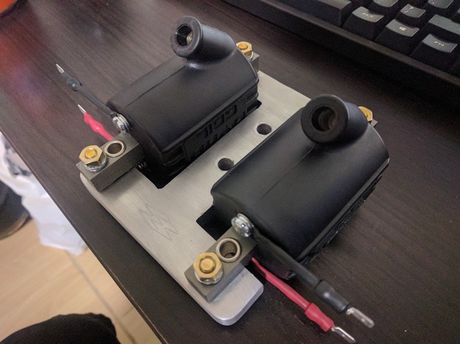

Dynatek DC10-1 coils, Magnecor KV85 wires, new NGK plugs - I did these all at once and had a aluminum bracket made up to fit the dynatek coils, WOW! What a difference, first time starting and I swear before my thumb had reached the bottom it had started and was idling smoothly.

File comment: Coils on bracket with spade connector fitting I made up to keep original harness.

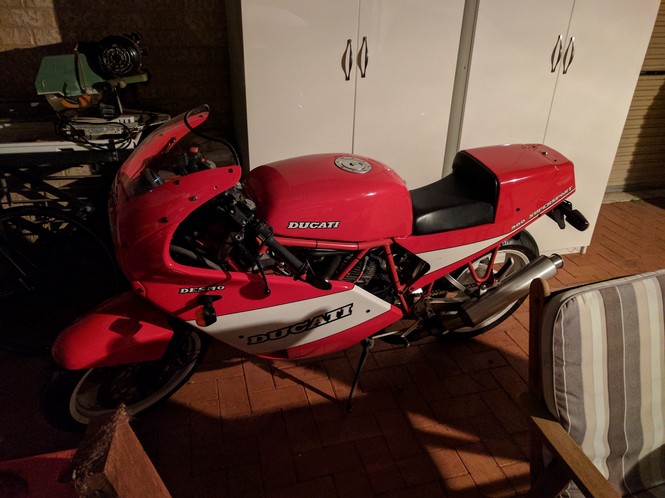

File comment: Single seat cowl fitted and useless mirrors removed.

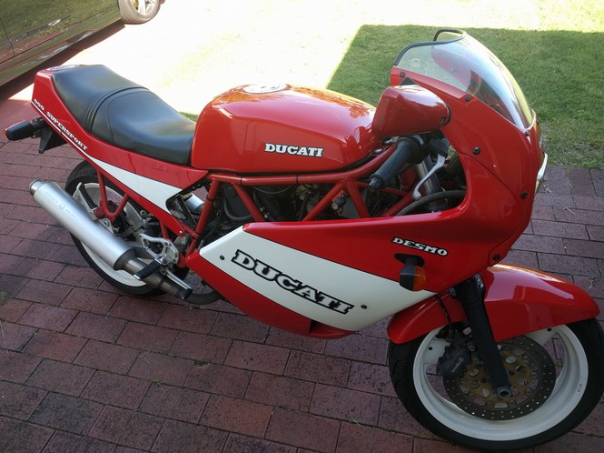

File comment: When I first got her home.

Welcome to the forum. That's a clean looking 900SS. I like the bracket for the coils, too.

Hi mate i have the 89 900 as well, with magnetti ignition and interested in the dynatech coils, looking on ebay and they seem reasonably priced are all the DC10-1 COILS the same as some are advertised for certain models of bike , also do your coils bolt in the original bracket holes, sweet bike mate ,enjoy

If you have a Kokusan ignition (2 blackboxes) they will work. It doesn`t matter what bike the coils are for or from as long as they have 3-5 ohms primary resistance .
