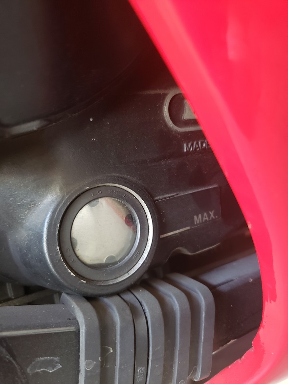

When you do your oil changes, are you putting in 3.5L of oil? I put in exactly that amount, which is the listed capacity in the owners manual, and it completely fills the view window when the bike is upright.
Here's a picture of the sight glass when on the side stand. There's no min level and the max is crazy low. Do your sight glasses look like this too?

So I was talking to a friend of mine in the motorcycle industry. Apparently that max line is a sticker that was applied to bikes during this time period. It seems that a common complaint at the time was that the Ducs took a long time to warm up. The Italian solution was to drop the oil level...

I never put in the whole 3.5 litres. After draining the oil and changing the filter (filling the filter before attaching) I fill the oil until it is half way up the sight glass. After running the engine and letting it settle for a couple of minutes I top up until it is again half way up the sight glass (where it should be). This usually uses 3 Litres or very slightly more. On a normal change there is always some residual oil left in the engine. The only time it will take a full 3.5 litres is with a completely dry, say newly rebuilt, engine.

I agree. Bike upright and half way up the glass.
