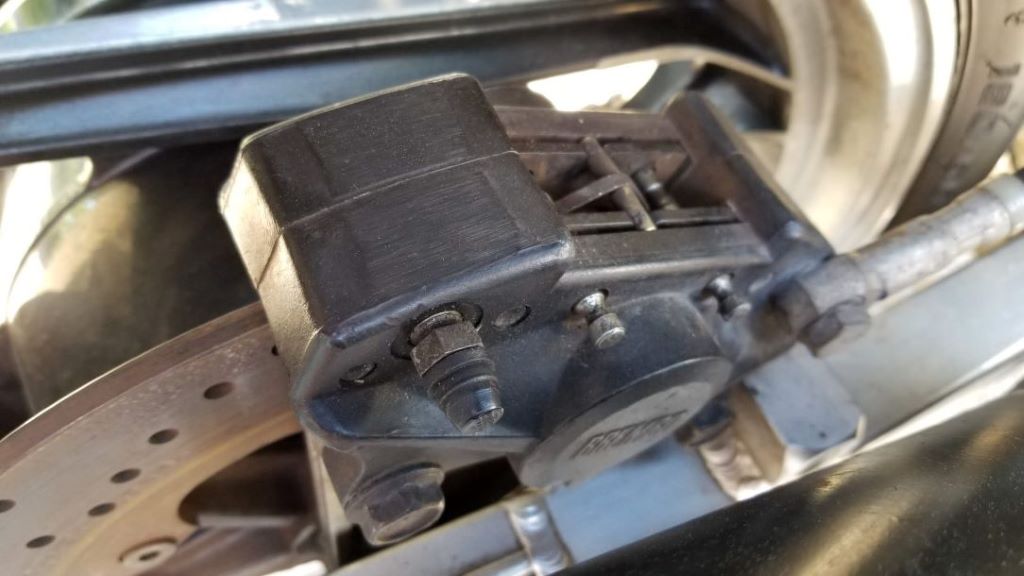

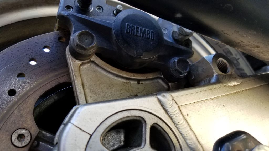

This may be part of the problem. Wondering if this bike has a different caliper on the rear.
Pads are the same as the front wheel. Double pin retainer. Also I think the pressure ratio between the rear master cylinder and the caliper is way off. It's been bled, checked that the pistons are free and I adjusted the pedal but there is very little pressure on the rear caliper.

That looks like a normal rear brake caliper.
Have you tried adjusting the actuating rod between the brake pedal and the rear master cylinder? This is threaded and adjusts the position of the plunger inside the master cylinder. If adjusted too much one way it will restrict the brake fluid from returning, which builds up pressure until the brake locks on. Turned too much the other way the brake doesn't work. It has a happy place in the middle.

The SBK 519HF (and EBC FA047) will not fit as those are for the 907IE's caliper which is the one used on the SS, Monster etc etc. Those calipers have one center pin that holds the pads, the one of the Paso/ Sport has two.
It may be that you have crystalline deposits in the master pump or caliper. When I rebuilt mine there was quite a bit of blue stuff in both but specially in the pump.
