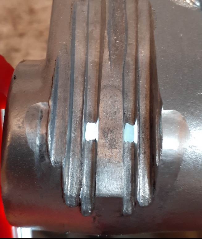

In short, the chain wore thru the swing arm and it looks like it's just at the cage of the bearings. If I knew a good welder here, I would attempt to see if it could be saved.
Now I know why the previous owner cleaned everything off but the crud on the swing arm. Lol. This bike is definitely a learning experience too. I'm really starting to get higgys post.

Into the cage for sure
 Post subject: Re: WTB 907 swing arm
PostPosted: Mon Jul 13, 2020 1:55 am
Thats what happens when the chain is to loose, but that aint the worst Ive seen . I would not panic about that to much , make sure the chain is properly tensioned and fit a new chain slider ( snigger)to the swingarm and try not to think about it .
