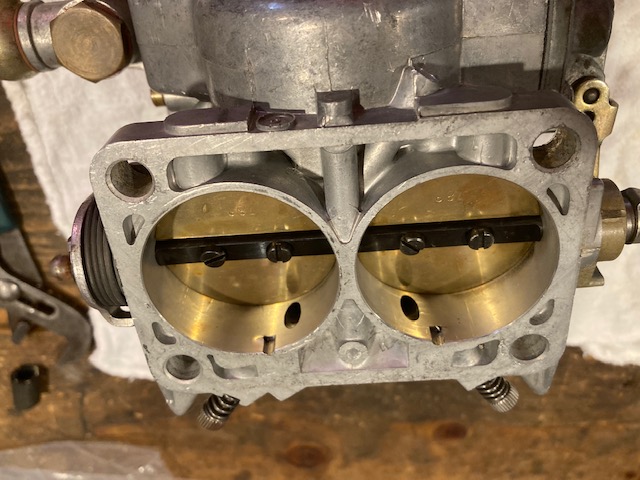

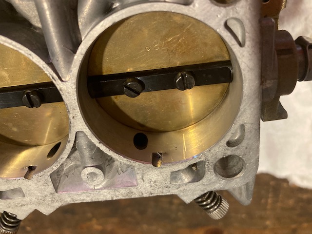

Well, my adventure into Weberdom just got a little interesting. Ordered up everything I need to rejet/reset, all arrived, oh boy, time to start work. Then discovered whomever last worked on the Weber screwed the fuel/air mixture screws in so friggin tight they actually started to blow out the inside of the throttle bore (see pics). Incredible. I've never seen anyone do that. Is there any chance it's useable like this? Asise from the likelyhood that I won't have shit for control over baseline fuel/air mixture, what will it mean to the rest of the operating range? More than a little bummed as I was excited about returning the Paso to stock. Anyone have a parts carb?

I believe the idle mixture screws are useful only for idle mixture setting. I read about this on a blog for the Weber DCNF from a Ferrari Dino owner. The idle jet itself is really the important one, since it controls from idle to 3000rpm. You might be able to get away with new idle mixture screws.
Here is the DCNF blog:
http://dino246blog.blogspot.com/2014/08 ... s-and.html

Thanks for the link, useful information.
